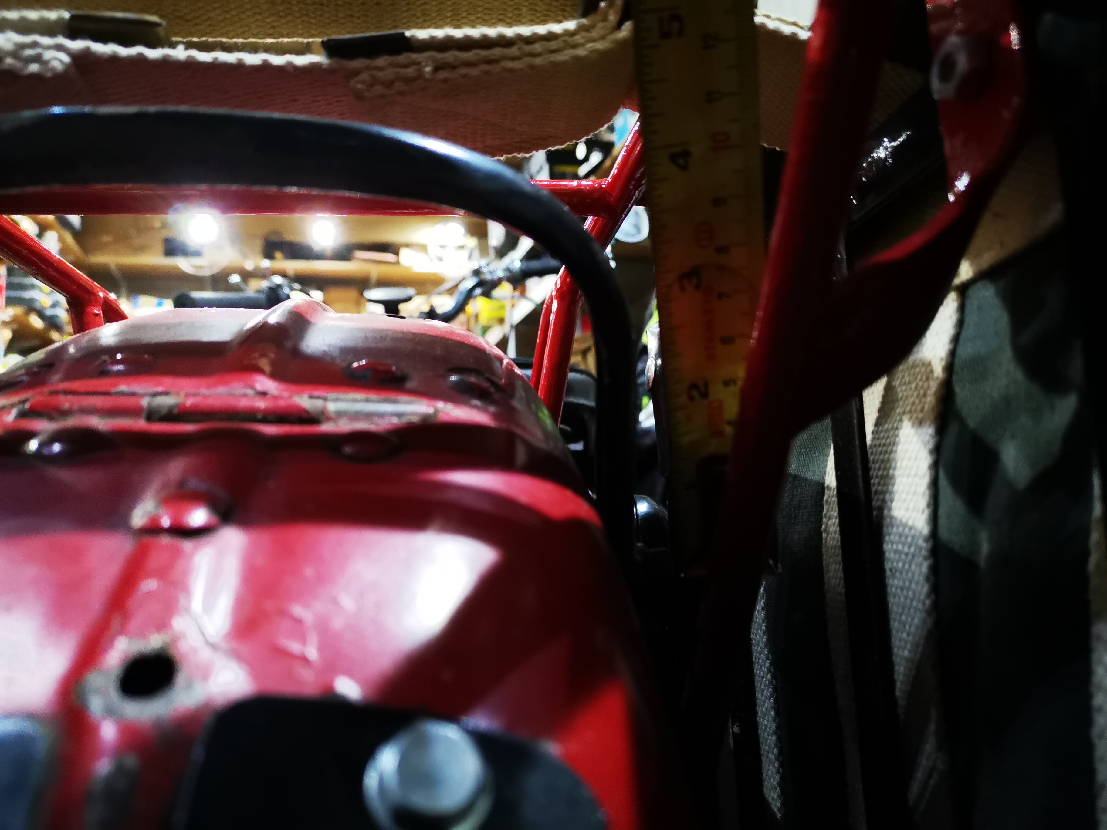

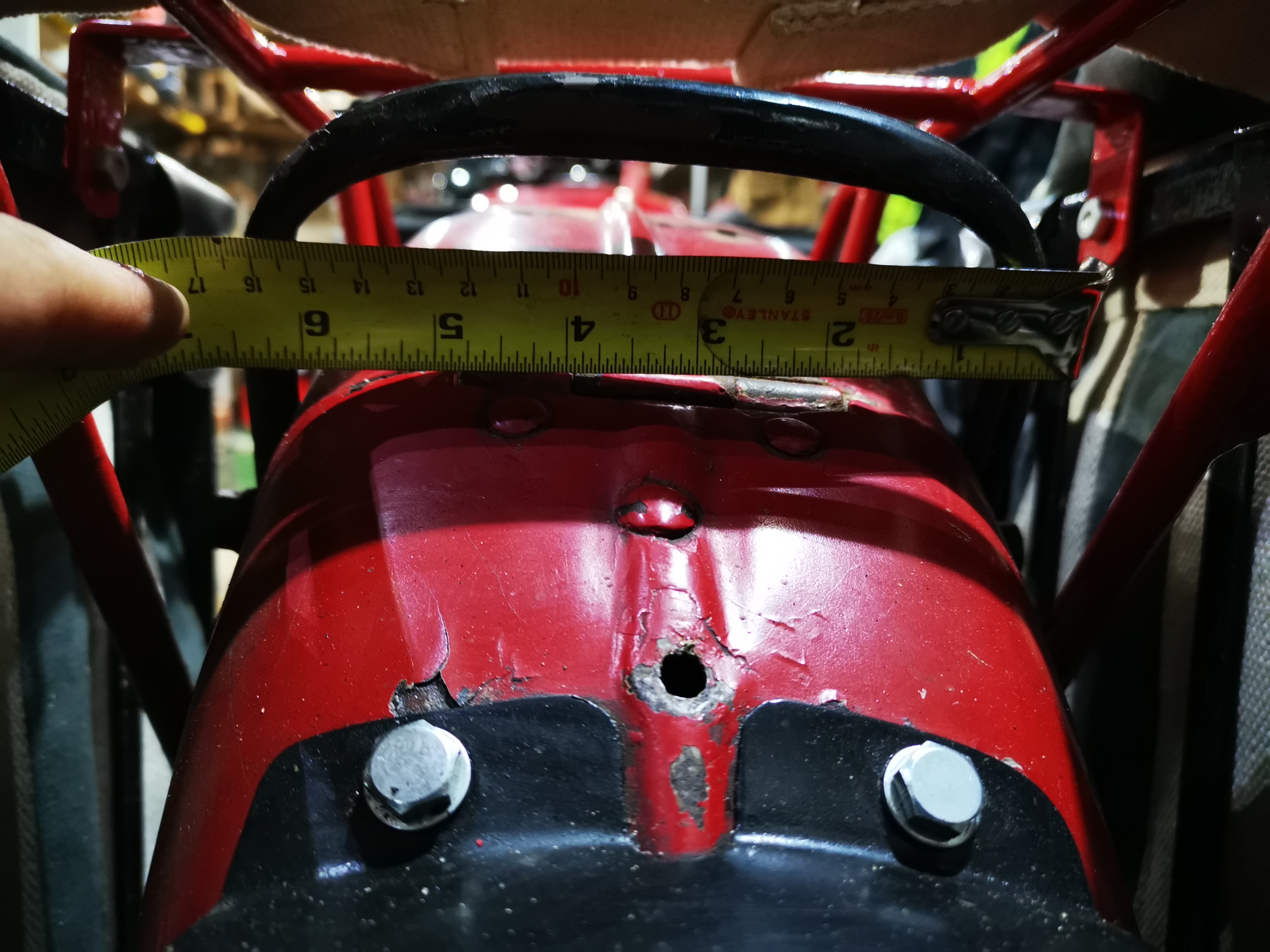

Not ideal but hopefully better than nothing!Adz.F wrote: Fri Feb 10, 2023 1:23 pm Simon,
That would be amazing please? Its for the WNG that I require. Mines a 45 but it should be the same for all.
Many thanks
Adam
Re: Different mudguard lifting handle dimensions
Thats great, thank you! Recieved a copy of the drawing today too so I should have everything I require.
